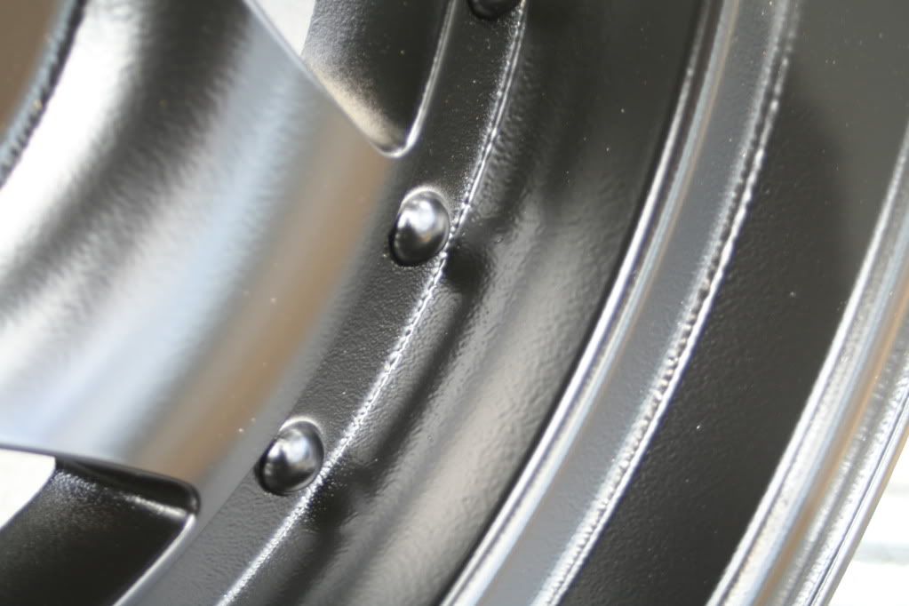

    i knew going into this that powder around the beads were going to be iffy cause its hard to clean with a scotch brite. i have a sand blast cabinent ready and i guess i could use chemical stripper if needed. this was a test piece so no worry. Some areas looked great to me, while others not.
    pics:
    dust visable is on top of the powder from transporting. didnt wipe before pics
    small piece that was in the oven same time and temp as the wheel (roughly 4inch x 10 inch)
    ideas?
